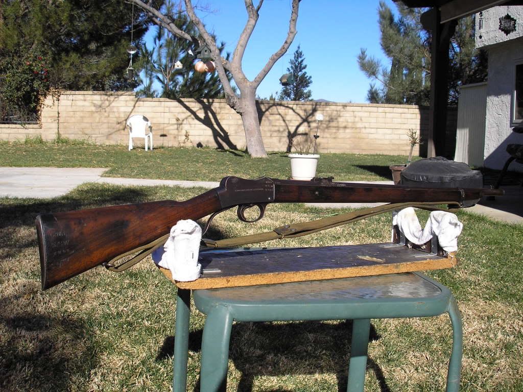

Some years ago I bought a pre 1899 BSA Martini Cadet rifle from a company in Australia. U.S. laws allow (or at least did then) the importation of pre 1899 arms into the country without jumping through all sorts of hoops. I got a nice military marked rifle with some wear and use but with a perfect looking bore. The problem for me then was that the proper heeled bullets and .310 cases were hard to find and expensive. Many of these rifles had been imported into the U.S. in the 50s and either rechambered to .32-20 or rebarreled. The .32-20 rechambering usually didn't work because the .312 dia bullet was pushed too fast through the .32 bore and the bullets would tumble.
A shooter told me about using .32 S&W long rounds with lead bullets in an unmodified .310 cadet. I was skeptical but gave it a try. It works just fine! The lead bullets are so soft that they upset in the bore and give great accuracy. The cases bulge but extract without a problem and due to the low pressure of the round almost never split and can be easily resized and reloaded. I now reload the .32 long cases with a swaged 90gr .314 Horndary semi wadcutter bullet and use 2.4gr of Unique powder. It sounds like a popgun when it fires and gives great accuracy out to 50 yds. I was worried about a bullet running out of steam and getting stuck in the bore but they all exit just fine. I always make sure that there is a hole in the paper target for each shot! The only problem for me is that it is so enjoyable to shoot that I can go through 50 rounds easy in a shooting trip which means I have to sit down and load up more!

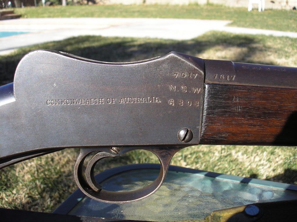

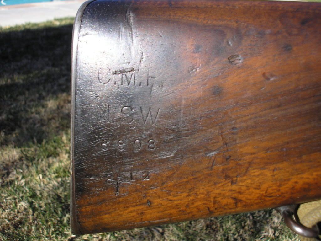

Thats a great looking rifle you have there with all the matching numbers .
Dave
