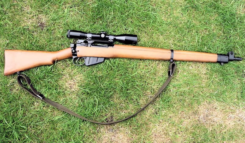

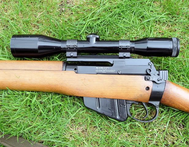

I have one of Fulton excellent scope mounts. It flits between my number 4 and no5 Enfields. As you know no gunsmithing required. The scope in the picture is a Zeiss diatal 6x40. I am a firm believer in the old adage you get what you pay for, ask any stalker how many pairs of Bino's he bought before he bit the bullet and bought a good pair. Same applies to rifle scopes. I have yet to squint down any cheapo that compares favourably with my Zeiss, Swarovski, or Nightforce. As Dromia points out make sure any scope you are considering buying has enough internal elevation adustment to get you out to the desired range. Not familiar with the Armalon scope mount, but I'm guessing it will be a nice bit of kit, and if it has the built in ramp to give the required elevation it will widen your choice of scopes. If you can find a gunshop frequented by Stalkers you may be able to pick up a bargain second hand scope at a reasonable price.. Andersons of East Grinstead comes to mind.

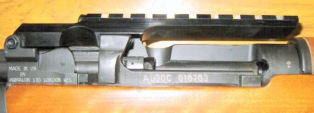

The Armalon mount appears very similar to Fultons mount, though I believe Fultons is made of steel whilst the Armalon is made in aluminium.
Armalon mount..

Jenks...there is no support for the front of that rail...Jenks wrote:The Armalon mount appears very similar to Fultons mount, though I believe Fultons is made of steel whilst the Armalon is made in aluminium.

No there isn't, it rests on the receiver bridge and is as solid as a rock. I have one to mount my scope on my stalking rifle which gets some rough usage at times and the mount has been excellent.
Evidently from Jenks's post Fultons have copied the Armalon design.
