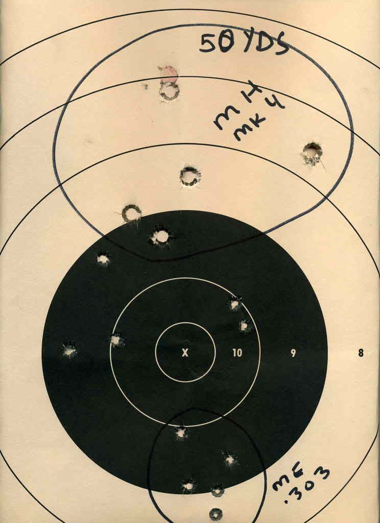

Nice shooting! I haven't gotten the hang of a good grease cookie to keep the fouling softened up and mine gets pretty fouled after more than 5 rounds and needs a wet mop swab out. I have a MkIV also and use a 480gr .466 bullet which is the only one I can find to buy. I don't cast bullets. I loaded up some more rounds with more olive oil in the beeswax mix for the grease cookie to hopefully reduce the fouling but haven't had a chance to try them yet. I'm sure a .468 bullet would improve matters.
This was with the .466 bullets, Pyrodex RS powder, and re-sized 24ga brass shotgun shells neck sized.
Same rig but also used a Martini Enfield in .303 on the same target to economize!

I use a beeswax/tallow/lanacote mix for lube and cookie. For the cookie I sandwich the mix 'tween two beeswax discs.
Tallow and Lanacote are available from ship chandlers.
I have also been using a dollop of udder cream on the nose of the boolit which keeps fouling soft, a tip I picked up from a member on the BM forum.
