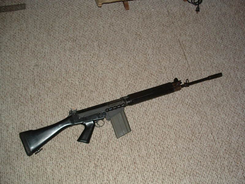

This is a Imbel I built up on a DSA receiver.

BTW, nice looking FAL......

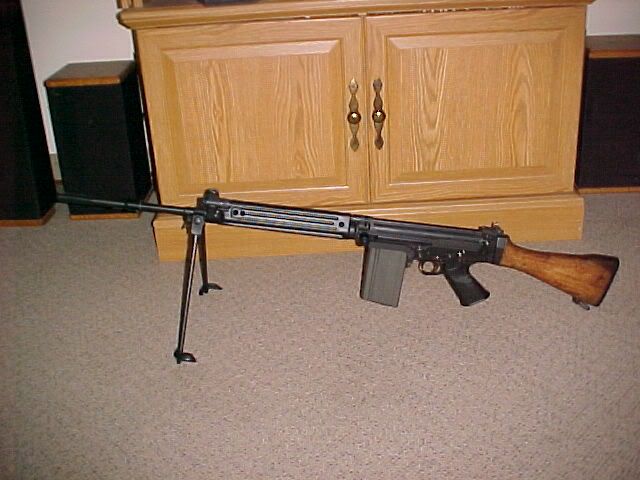

I assembled a Belgian (made for post war germany) G1 on one of his early receivers.
Fine receiver!
