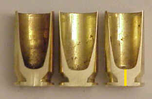

3) The 45 ACP offers three recognised pressure levels - ACP, ACP+P and Super,

Just my thoughts on the subject.From left to right - .45 ACP, .45 ACP +P, .45 Super®. The difference is actually quite significant in the web area, as marked by the yellow vertical line. The Winchester measured .175", the Starline +P .182" and the Super .198". .023" over standard is a lot of brass and makes it easy to see what the Super brass is critical to proper function and safety.
