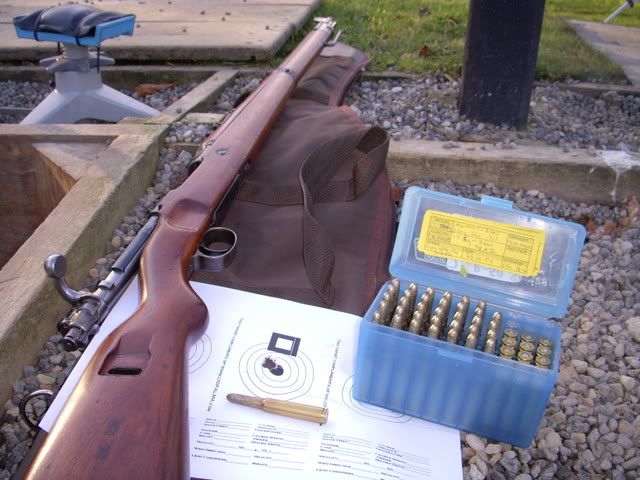

Having not worked for the last week or 2 I decided to get some of the rifles out and have a dig around.
Anyway this one a No1 Mk111* made in 1943 by BSA I thought, well I was nearly right what it turns out to be is a complete matching Dispersal rifle, not made up from bits and bobs as such , this was planned after severe bombing of the Birmingham weapons plants by the Germans and to satisfy the need for weapons after Dunkirk, apparantly not a great many of these survived intact as they were either scrapped or sold on after the war.
When I got her earlier in the year she was covered in varnish which I have now removed and applied liberal coatings of BLO so now looks the part. anyway some pics not great quality as they are from my phone

No you don't see many dispersals over here although they seem plentiful in the states. How well does it group?

Ive only ran 20 rds through it quickly all were on the target at 100. Im planning to start reloading 303 later in the new year so ill let you know will probably stick with 174gr bullets and N140
