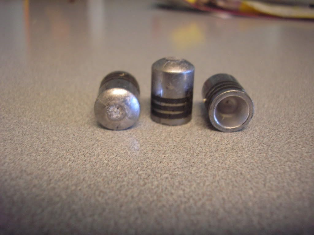

If you can find these in the UK, they work really well in my MkVI. They are aa .455 hollow base bullet with a rounded flat nose for paper punching. I get them from a guy in Pennsylvania and he casts them using a Lyman mold from what I understand. Perhaps your S&W has a couple chambers that are not sized properly compared to the other chambers which allows the .452 bullets to enter the throat off kilter which gets them down the bore not set up properly?
