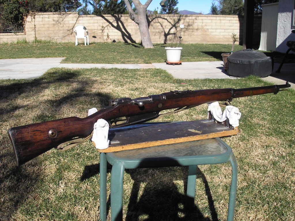

#1 Post by rufrdr »
Paging GEW 88 shooters! Who is shooting GEW 88s out there? Still in the original .318 bore or rebarreled to .323? There are a goodly number of 88s here in the states. They came in waves, post WW1, in the 50s-60s, then in the late 80s-90s. Many passed through Turkey on the way to the states. Remington 8mm soft point ammo is made with the .318 bores in mind as their bulets are .321 as a compromise between the .318 with the relieved throat and the .323 for 98k's. I bought a Turk converted 88/05/35 with a .323 bore on a whim. Only paid $124 for it and didn't expect much but it is a real shooter! I reload using 150gr .323 bullets at around 2500 fps to keep the stress down on the action. The main danger for these rifles is a case failure at the base. It will wreck an 88 action which is why I advise never shooting surplus ball in these rifles. A lot of stateside 88 shooters use lead bullets at very moderate velocities to further keep stresses down. I'm of the school of thought that the Turks put thousands of rounds of their nuclear powered 8mm ball through this rifle and it is still in one piece so my moderate jacketed bullet reloads aren't a problem.
The bore is unpitted and the trigger is like a target rifle. It is a 10 ring shooter at 100yds which is good enough for me. I'm temped to get an original 88 in the .318 bore but prices are starting to climb on them so I may have missed the boat. Let's here your experiences with the 88!

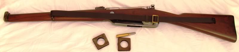

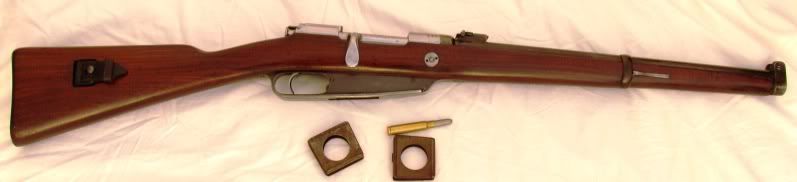

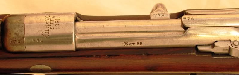

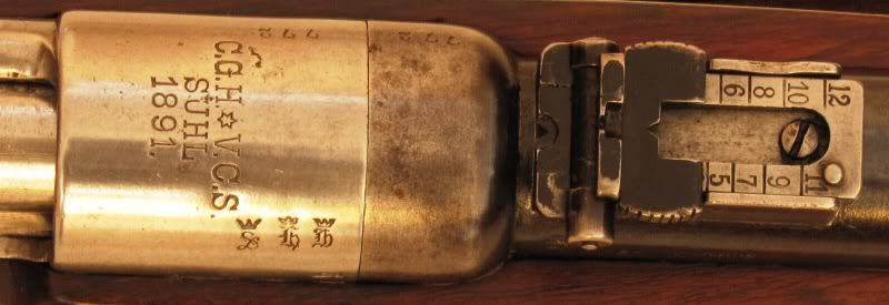

jjvc
Posts: 590
Location: Durham
Re: GEW 88 shooters?
#8 Post by jjvc »
I have a sweet little 1891 Kar 88 in the original calibre. Reciever marked C.G.Haenel and V.C.Schilling, Suhl.
Its fed a strict diet of cast boolits.
Joe
#9 Post by ovenpaa »
Pictures like this make me wish I had yet another cabinet, however that would mean an alarm system as well as we are close to maximum between the two of us. My renewal is later this year (I had better check when!) Maybe I will add a couple of slots then and see what they say.
