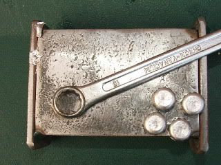

Re: shotgun slug casting
A 15MM AF Ring spanner used as a Mold will give you a slug weighing around 400 Grains with a O/D of 0.680".
Hold the spanner on a flat metal surface and dunk in water when it hardens, tap the slug out.
