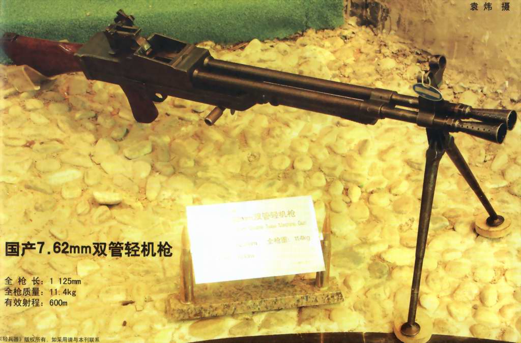

Ian has an article up very interesting:
http://www.breachbangclear.com/wtw-chin ... n-7-62x39/
This pic gave me pause:
Sixshot6
Re: A 7.62x39mm BREN gun
#9 Post by Sixshot6 »
Fedaykin wrote:Ian has an article up very interesting:
2 barrels firing at the same time? Aren't Gilboa doing that with the snake?
