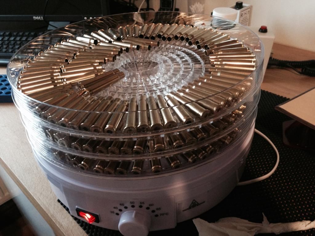

bought one of these off ebay for £23 holds around 400 cases, takes about 30mins to dry them all and no aggro from the missus for taking over the oven

Mitch308 wrote:bought one of these off ebay for £23 holds around 400 cases, takes about 30mins to dry them all and no aggro from the missus for taking over the oven
:o
What is that magical thing...?! :o
