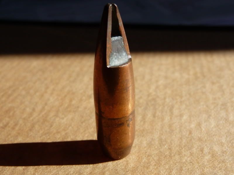

Many years ago I bought some 168grn IMI,(samson) 308win Match cartridges. They were very accurate and the bullets most definitely hollow point though not classified as Expanding. I believe the hollow point was used to shift the Centre of gravity rearward to optimise the bullets potential accuracy.
168 Grn. IMI (Samson) match grade bullet
Jenks
Jenks
