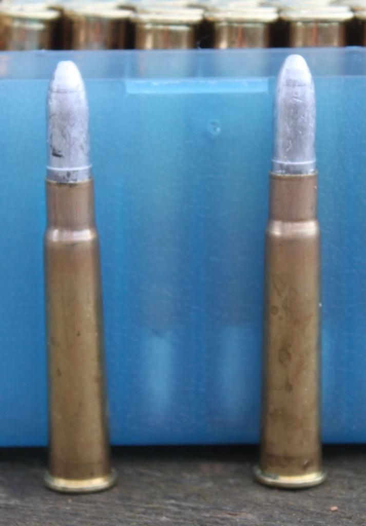

Load was just a standard 303 of mine, NOE 316299 215gn GC boolit sized to .315" 2500 lube over 20 gns of Vihtavuori N110, CCI LR primer in an HXP 82 1 x fired case giving around 1800fps. Boolits were seated out to touch the lead other than that nothing else was done, I didn't even slug the bore. Just wanting to get some rounds through it to break in the barrel for lead, all this rifle will now shoot, before getting down to some load development.

The ammunition:
