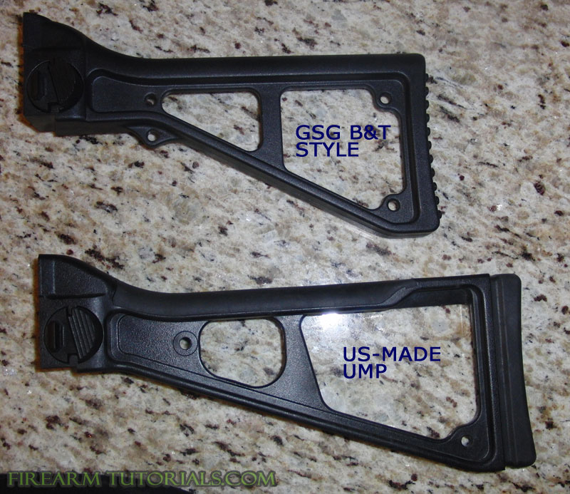

Have you seen the UMP stocks people put on them, then it would be no different to a 10/22 with a folding stock which is legal.
http://www.hkparts.net/shop/pc/GSG-5-Fo ... k-p786.htm
You might find an airsoft one for a GSG might fit.
