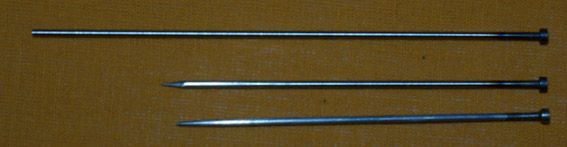

The best thing to use seems to be plastic moulding ejector pins they work well are easy enough to modify & significantly cheaper!!!
the picture below shows from top to bottom unmodified ejector pin 100x1.5mm with 3x1.5mm head, ejector pin shortened to 76mm & sharpened, blunt pin that was originally in my chassepot.
I purchased some pins from a dealer in Switzerland the quality is not very good but copied them for length I canot find my reference but think the original length is shorter 73.5mm.

Sorry correction to post above.
I purchased some pins from a dealer in Sweden the quality is not very good ........
David
