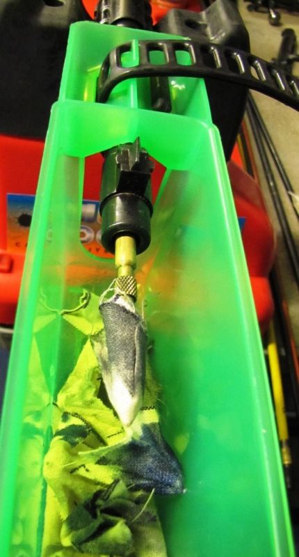

Adam was doing a demonstration of C2R and I took along my Steyr to see if it would improve it.
To be honest I wasn't expecting anything to come out as after using my usual Montana X-Treme cleaner the Patch Out & Accelerator I tried didn't find anything at all.
After letting the C2R stand for 25mins I was surprised to see a slightly blue patch emerge from the bore! so obviously this C2R stuff works!! :good:

I'm convinced it does what it say's on the bottle!
I took along my M95 Steyr, which I thought was clean, we ran a dry patch through to clean out the youngs 303 that I always leave in the bore. After standing for a half hour out came the metallic fouling much to my surprise. My pics don't show how blue the patches actually were.
Joe

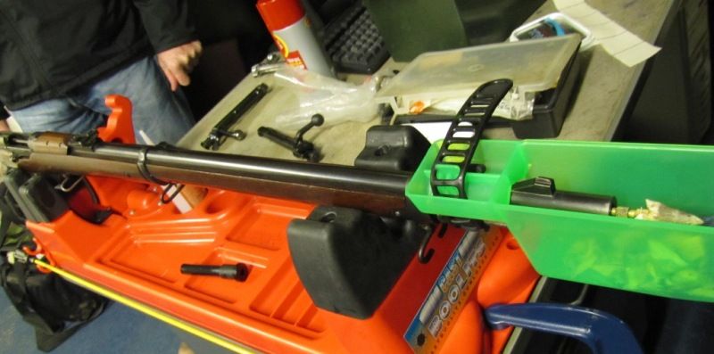

And a old clunker of a No.4 which shows sign of heavy fouling.
I'll e mail you the rest of the schnapps Droomie. tongueout

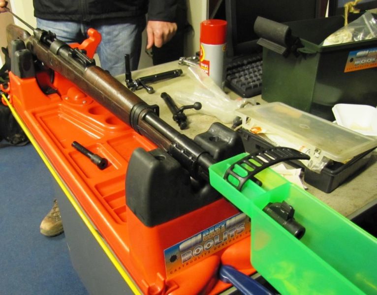

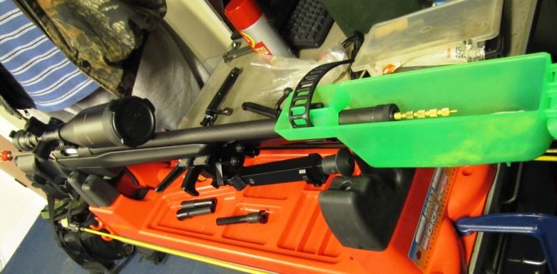

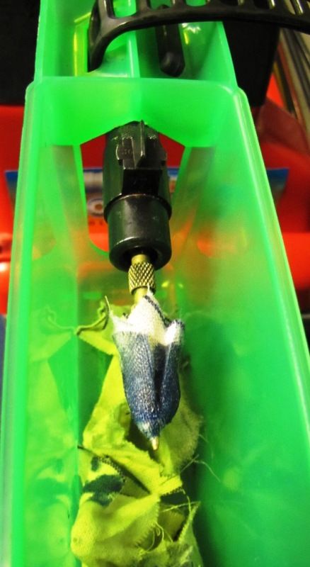

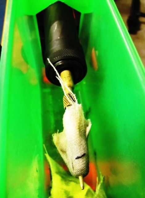

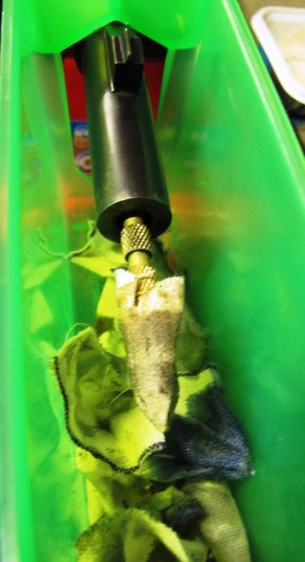

Here are some more photographs from our C2R Cleaning Fest this morning at the St Giles Yarners Rifle and Pistol Club. :grin:
These two show the patches coming out of Jeff's Steyr SSG. Jeff had cleaned this his favourite bore cleaner Montana Xtreme, he had then re-cleaned it with Wipe Out Patch Out and Accelerator as a test and the patches came out clean. Today however after a 25 minute soak with C2R more copper was removed.
The blue on the patch hasn't really come out in this photograph
These shots are of a RC K98 new in with a barrel of unknown condition.
Blue copper covered patch followed by black carbon covered patch, something about a Scandinavian beer and unreachable parts comes to mind.
Next up was a lead shooting Long Lee Metford, this rifle was considered clean by its owner but the C2R took even more carbon fouling out.

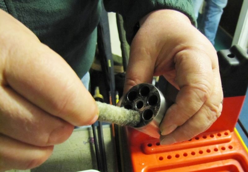

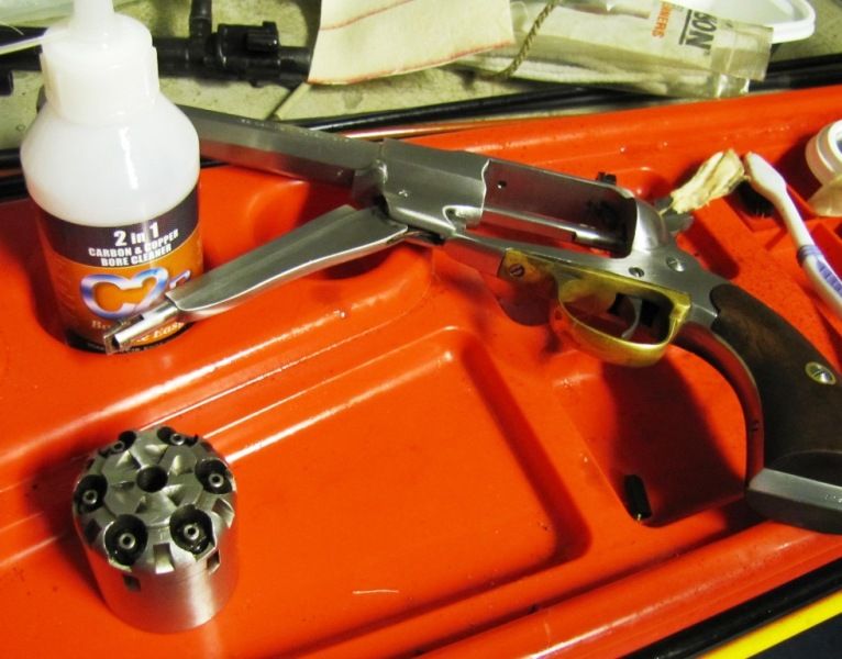

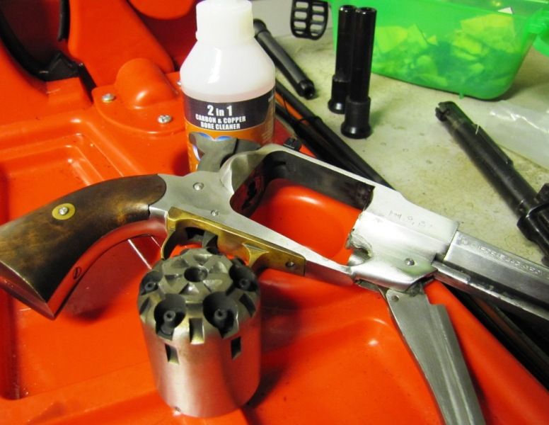

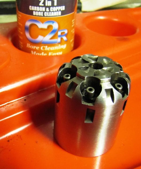

The surprise of the day was this BP pistol, having been fired on the range we wiped it down and sponged out the barrel and chambers with C2R and left it for 15 minutes or so. The Pistol was then wiped down with moist patches the barrel and chambers were cleaned out with wet patches also. The BP fouling just wiped away even at the top strap/forcing cone juncture. The powder used was Krankies nutty slack. A skoosh down with WD40 to remove any water residue a further wipe off and oiling and it is ready for the next time.
What can I say but, Phwoarrrrrrrrrrrrrrrrrrrrrrrrrrrrrrrrr!!!!!!!!!
