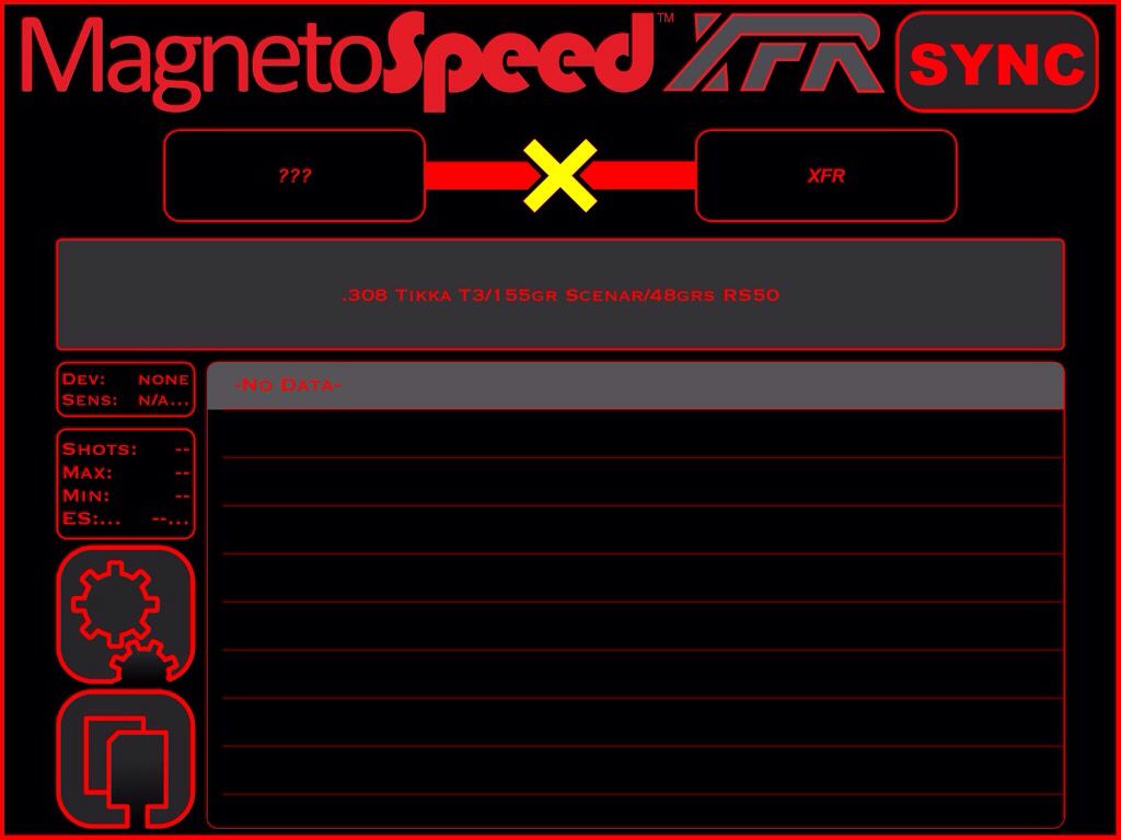

I have the XFR cable and XFR app, hovever the cable isn't not yet available here in Europe - I got mine from the pre-release batch Magnetospeed sold recently, it was acquired by a pal in the US and posted over. The XFR App was only released yesterday, I've downloaded it but won't get chance to try it until I'm on the range tomorrow.

A screenshot of the Magnetospeed XFR app on my iPad.
N.B. XFR has to have iOS 8.1 to work on an boing/iPad and the V3 has to be upadated to the latest firmware from the Magnetospeed site.
