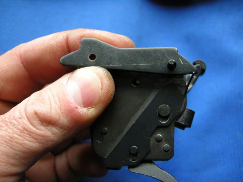

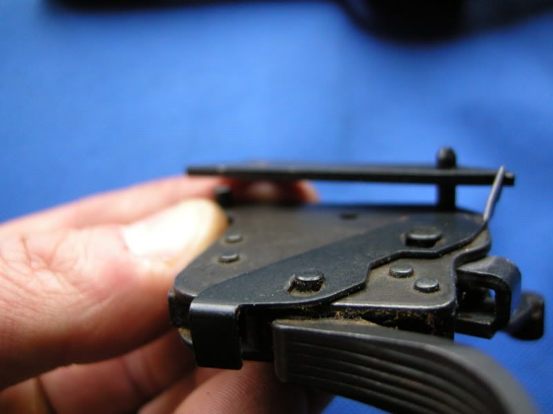

Trigger unit and bolt stop with link mech
Underside view with parts as they would be in action

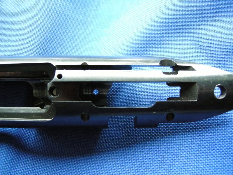

Underside action showing inlets for trigger unit and bolt stop

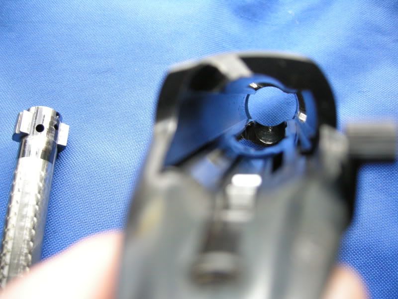

Bolt stop in normal position - proud to prevent bolt detachment
Bolt stop lever depressed

Many thanks all for replying and Ronin for the pictures, so the catch sits engages with the rear of the left lug as viewed from the rear. I had a feeling it had to be like this but needed a picture to confirm.
