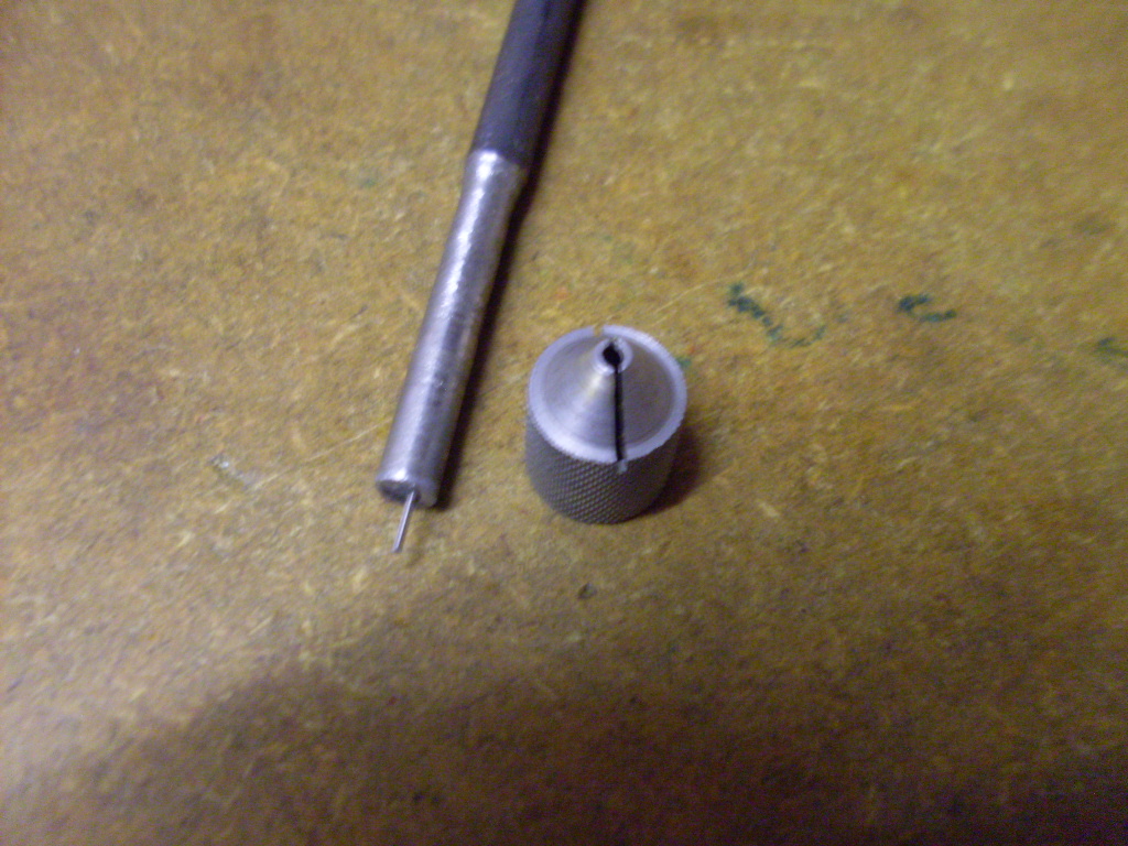

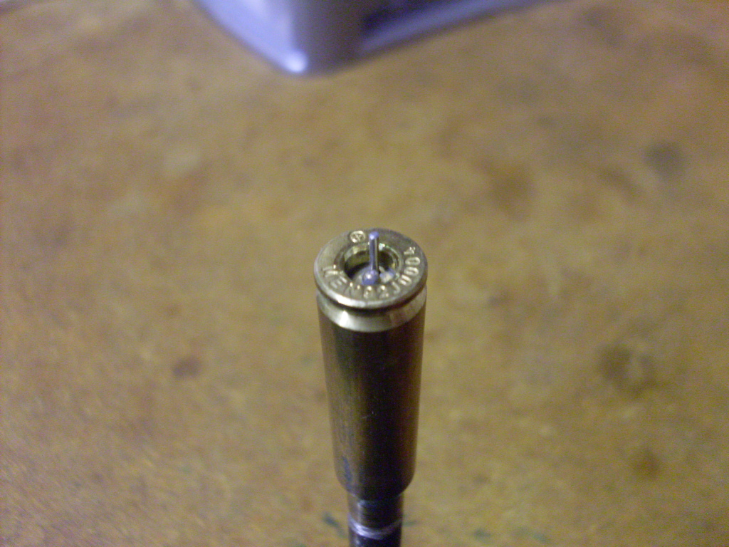

My method of de-priming and removing the primer crimp from Berdan cases using a Lee chamfer tool and pin.

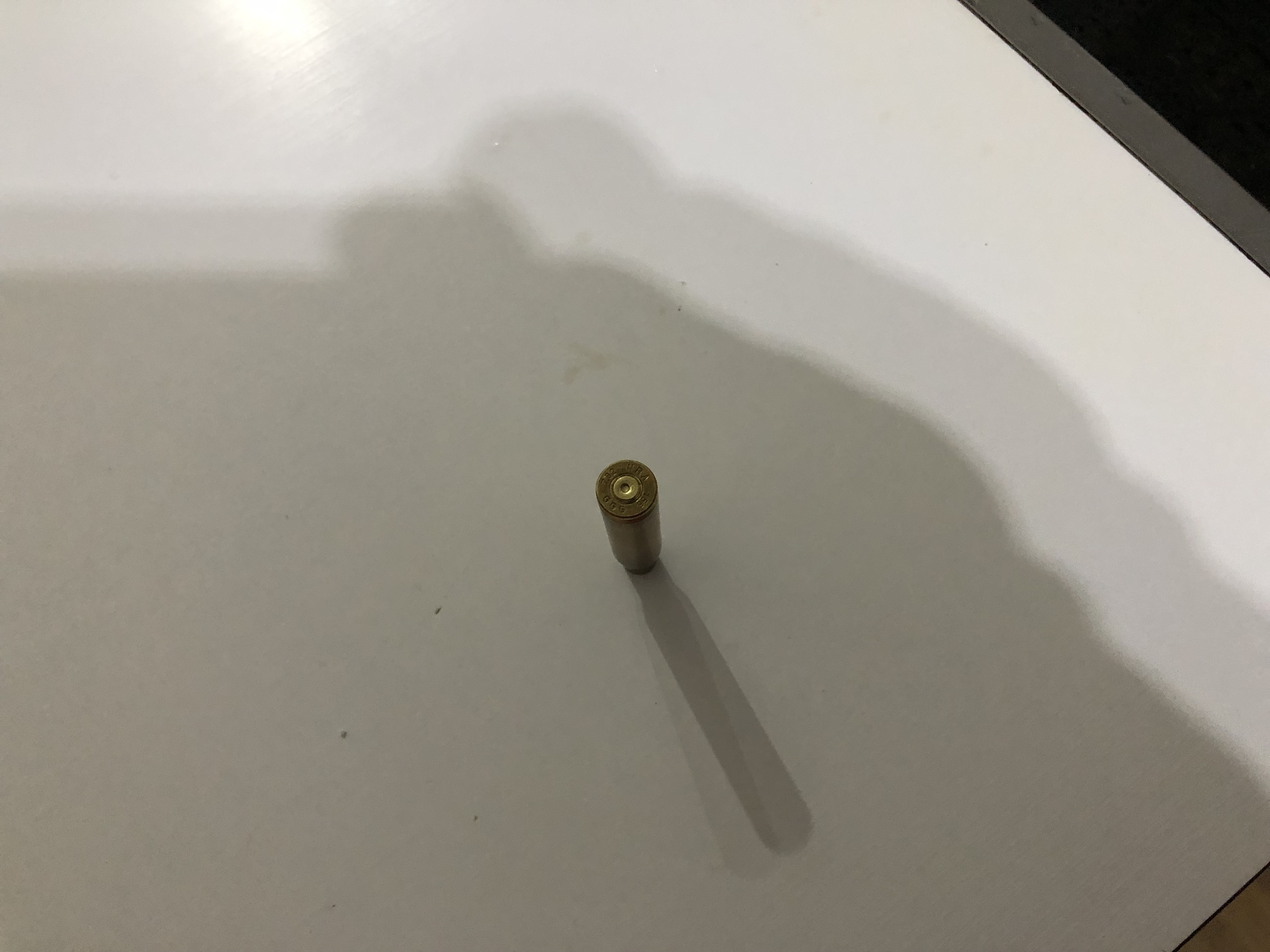

One thing it's worth pointing out is that the primers actually moved back to just proud of the case head by a midges dick, but they all went bang.
- Posts: 20242
Re: Just a word of caution regarding nato 7.62 brass.
Primer movement is common in low or no (as in this case) pressure firings.

I’ve tried removing the crimp on GGG 7.62 and 5.56 with both a chamfering tool and an actual proper RCBS primer swager tool and although both are quick and easy and both get the job done I prefer the chamfering method, only thing I will say is that the proper tool is more consistent, I did find seating primers a little harder though
