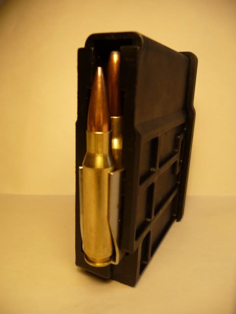

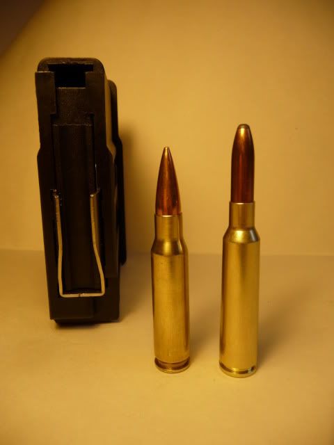

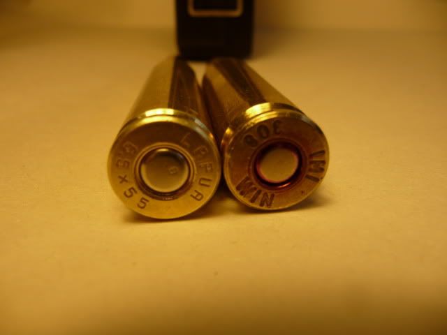

Looking at case-head diameters I notice that the Creedmor at .468'' is .012'' narrower than the 6.5x55se the 308win measures .473'' making it .007'' narrower than the Swede.
The magazine of my rifle will accommodate both calibres as will the standard bolt- head
I'm pretty sure that the creedmore would fit and feed from the magazine and would probably be ok with the standard Bolt-head then again would .012'' narrower be just a tad to narrow?
