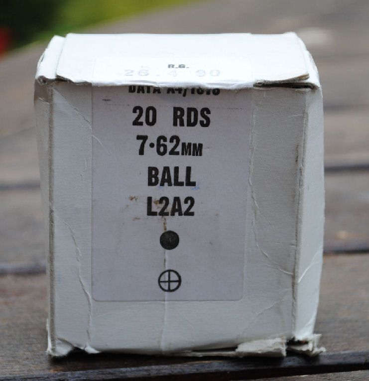

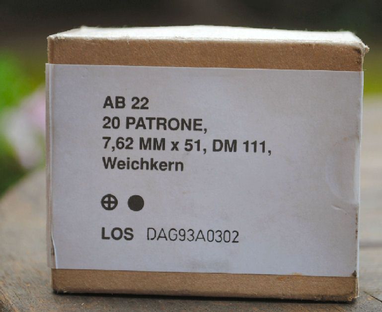

I've tried the RWS 155gn .308. Looks well made, is very expensive but still wouldn't cycle in my 7.62 or .308 rifles. I'm not sure if I have come across GGG, is that Mil Surp 7.62 or civi .308?
I've tried both of these and sold off the remainder when I found these didn't cycle either:
The ACR L1A1s are chambered for .308 which is meant to be softer brass than NATO 7.62 so should extract easier, however, there are other subtle differences between .308 and 7.62 such as shoulder angle which can affect head spacing. Interesting article below:
OK --- Let's address the oft-posed question "Are the .308 Winchester and 7.62x51 NATO one and the same?" The simple answer is no. There are differences in chamber specs and maximum pressures. The SAMMI/CIP maximum pressure for the .308 Win cartridge is 62,000 psi, while the 7.62x51 max is 50,000 psi. Also, the headspace is slightly different. The .308 Win "Go Gauge" is 1.630" vs. 1.635" for the 7.62x51. The .308's "No-Go" dimension is 1.634" vs. 1.6405" for a 7.62x51 "No Go" gauge. That said, it is normally fine to shoot quality 7.62x51 NATO ammo in a gun chambered for the .308 Winchester (though not all NATO ammo is identical). Clint McKee of Fulton Armory notes: "[N]obody makes 7.62mm (NATO) ammo that isn't to the .308 'headspace' dimension spec. So 7.62mm ammo fits nicely into .308 chambers, as a rule." You CAN encounter problems going the other way, however. A commercial .308 Win round can exceed the max rated pressure for the 7.62x51. So, you should avoid putting full-power .308 Win rounds into military surplus rifles that have been designed for 50,000 psi max. Reloaders should also note that military ammo often is made with a thicker web. Consequently the case capacity of 7.62x51 brass is usually less than that of commercial .308 brass. You may need to reduce recommended .308 Winchester loads by as much as 2 full grains, if you reload with military 7.62x51 brass, such as Lake City or IMI.

Yes have been through all the discussion about .308 versus 7.62. Not convinced, I think it all depends on strength of load, and expansion/contraction characteristics of the case.
The MEN/DAG German and RG surplus also have hard extraction in my rifle. However the GGG which is new made Nato spec ammo is fine.
I've also tried Privi 145grn which is usable, just, but not as trouble free as GGG.

+1 for the GGG for me, very smooth extraction. My rear sight is extremely hard to move, so much so that I thought that I had to press a release button to get it to go. I use a scope but I haven't noticed movement in the iron sight at all.
Isn't the MEN fairly hot? I certainly notice a difference between that and PRVI (Blue box) in my Rem, it's much more snappy, does that make sense?
