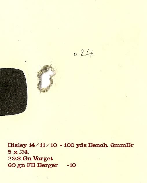

I'm using cci BR4's with lapua cases giving about 2875fps.
I see I have also had good results with the 69gn FB Berger's with 29.8gns Varget jumped 10 thou.
