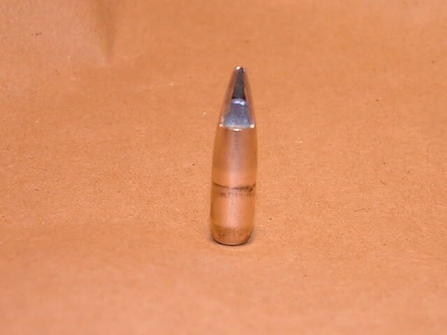

#6 Post by Jenks »
dodgyrog wrote:The hollow point moves the centre of gravity back in the bullet body and makes it more stable hence more accurate. (At least that's what I read once).
Picture of a .308win 168grn IMI Samson Match grade bullet, illustrating how the centre of gravity has been moved rearwards. All I can say is it worked. The factory cartridges that used this bullet where the most accurate factory ammunition i have ever shot.
