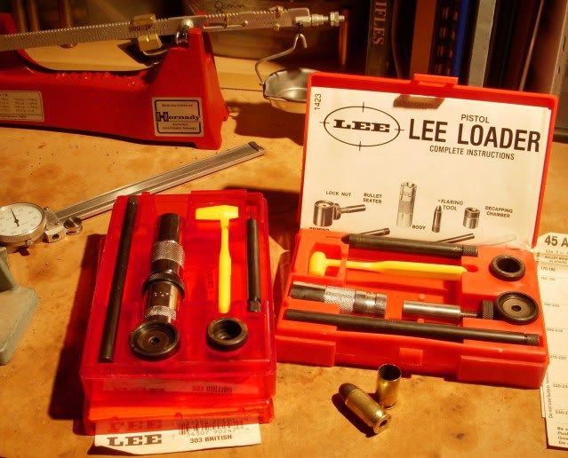

I enjoyed reading Sim G's thread on the Lee kit as i own quite a bit of the stuff myself, some good, some not so.
I do enjoy useing the Lee Loader on occasion, though obviously not for quantity handloading, and find them surprisingly effective and easy to use. My only dislike is the method of primer insertion (not good :roll: ) and prefer my usual method with the Lee Ram Prime.
Any other users or am i the only masochist here?

I have never owned a Lee loader may be I should give one a try looks interesting.

Yes, I've got a Lee Loader in 223 and 308. I've now moved on to "proper" dies, but I also found them surprising effective and quick.
I prefer using the Lee Ram Prime as well - especially after I had a couple of primers going off! :shock:

Joe do me a favour the Hornady scale in your picture can you mike the distance between the two counter ballance nuts from the beam to the nuts then from the nuts to the end of the threaded bit.
I think mine is out.

I think you will find that these need to be individually set for every scale. If you were to change your pan or hanger you would need to re-adjust the trimmer weights.
To reset the trimmers, first adjust the main leveling screw so the scale is level, set all poises to zero and the scale should read zero. If it is a little off then the main leveling screw will take care of it in the normal way - If it is a long way off then you will need to reset the trimmers. With everything set to zero and the pan fitted you will need to loosen the nuts and turn them a little in or out until the scale reads zero. Once set they shouldn't need changing, normal zeroing being carried out with the leveling screw.
Hope that helps.
