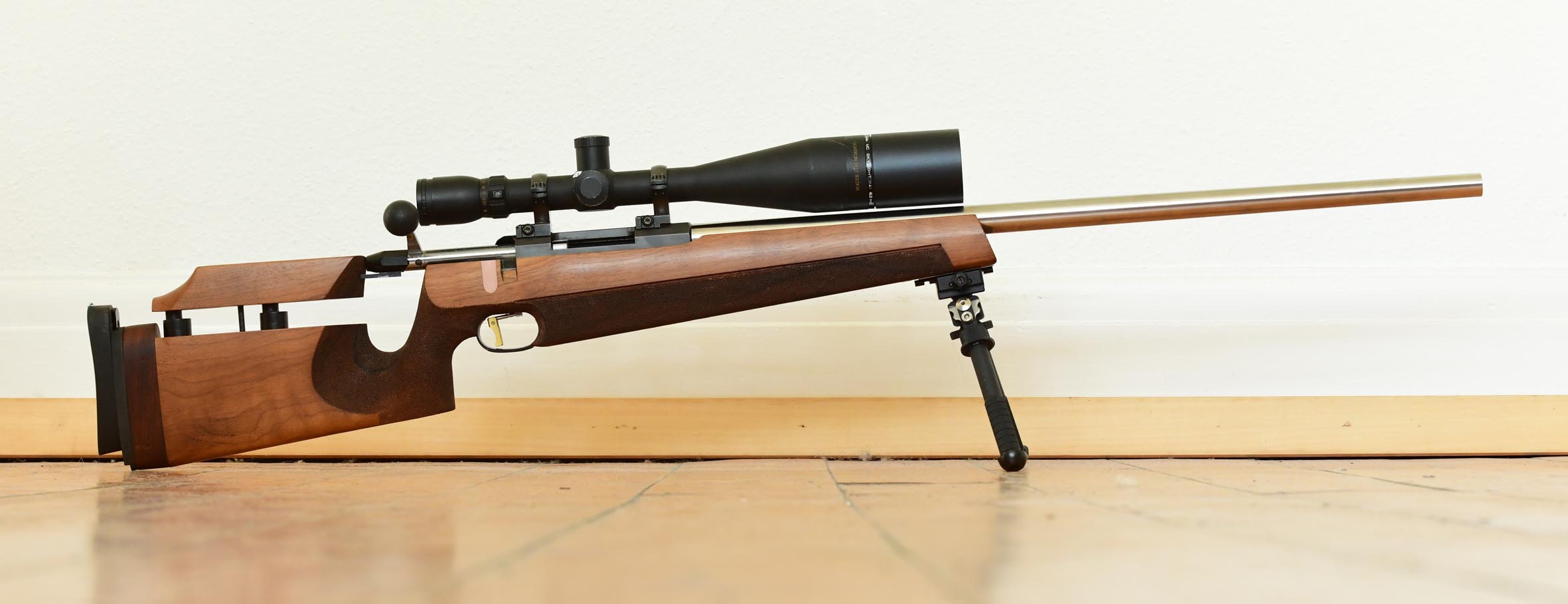

I've been shoe-horning a Tikka M595 223 into a Walther small-bore stock:
It's still very much a "work in progress" (note the Isopon in the .22 bolt handle slot), but I've got it to the stage where it fits me and it's fireable.
The action isn't bedded yet, but it is bolted to two metal pillars, fore and aft. These have been epoxied into the woodwork.
The cheekpiece will need modifying, there's not enough clearance for bolt insertion/removal presently, so unfortunately, it will need a bit of surgery.

That'll make a nice rifle when it's done.
