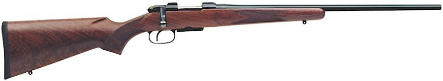

Well oomanses, Santa has delivered our CZ527 in 7.62x39, which looks like so:
Nice piece of timber, hammer forged barrel, set trigger (obviously), 5 round magazine.
We'll be using it out to 300 mards, occasionally a little further if circumstances permit, and are thinking about a suitable scope for it. Ideally we'd like a scope with a 1" diameter tube and a dedicated reticule for the 7.62x39 cartridge. If a dedicated reticule isn't available at the right price / tube size / magnification et cetera, we'd like something with several hashes to allow us to hold over at ranges other than zero. Any suggestions ? We're thinking of a budget up to £250 though less would be nice, and a magnification of x10 or less. Fixed magnification is fine.
