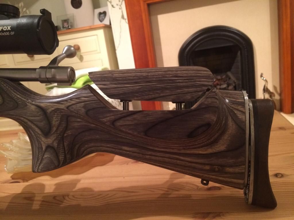

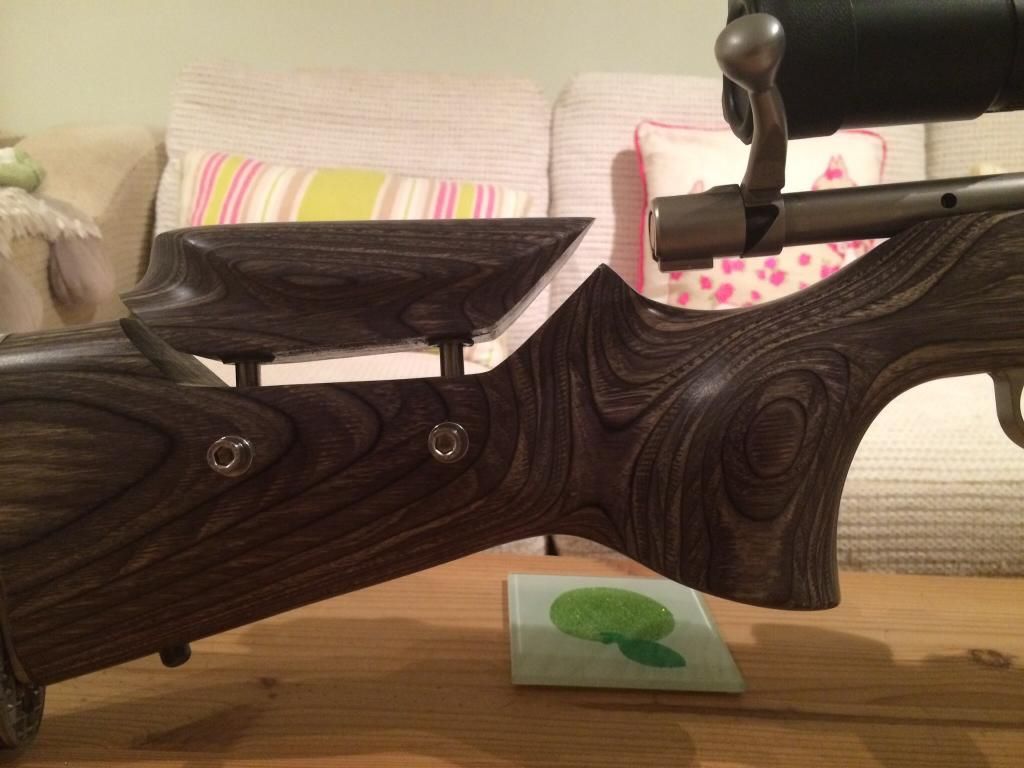

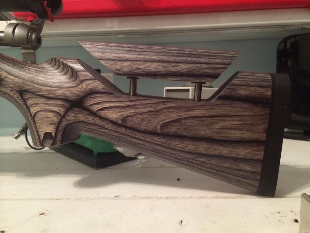

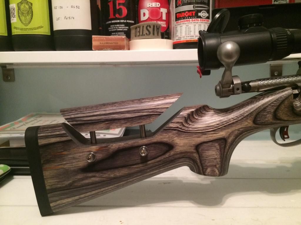

Hi all,
I've bitten the bullet so to speak and taken the plunge.
I removed the stocks, marked up where I wanted to cut, and went for it.
I polished up some m8 stainless bolts with the hex heads cut off to use as the posts.
I used some m8 rivinuts in the cheekpiece, and some m6 stainless hex bolts with rivinuts in the stock to secure the cheekpiece.
Howa 1500 left side....
http://i1188.photobucket.com/albums/z40 ... jpg1-1.jpg
Howa 1500 right side
http://i1188.photobucket.com/albums/z40 ... jpg2-1.jpg
Savage 12 F/TR
http://i1188.photobucket.com/albums/z40 ... jpg3-1.jpg
Savage 12 F/TR
http://i1188.photobucket.com/albums/z40 ... gejpg4.jpg
I'm going to change the hex bolts. I'm going to cut them off and cut a slot so they're flush. But other than that I think I've done an ok job.

i'd look for some st/st grub screws, but yeah, looks good to me!

Hats off to a guy with big balls, you have done a excellent job. I agree that the choice of fittings need to be improved upon but that's a small modification and given the quality of the cut and profile, I think you have done a great job....well done that man!
