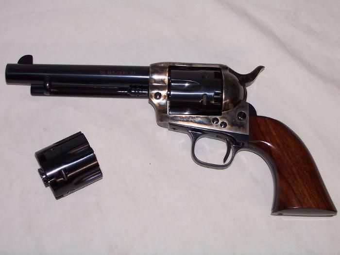

I've got my heart set on Uberti Cattleman muzzle loader and I'm going to put in for a variation and include an extra cylinder. In theory, and with the assumed patience of my fellow Turning Targets shooters, I could occasionally shoot PP1 with it.
I have no experience of Black Powder but I'm thinking Pyrodex or Triple Seven would be a better option in this case. I've looked into nitro conversions, but I think the only modification I would want to make (purely on the basis of how the gun looks), is some replacement nipples that allows it to accept shotgun primers.
Can anyone school me on BP substitutes, do they produce less smoke, flash, mess etc? Are they even suitable for a Uberti Cattleman?
