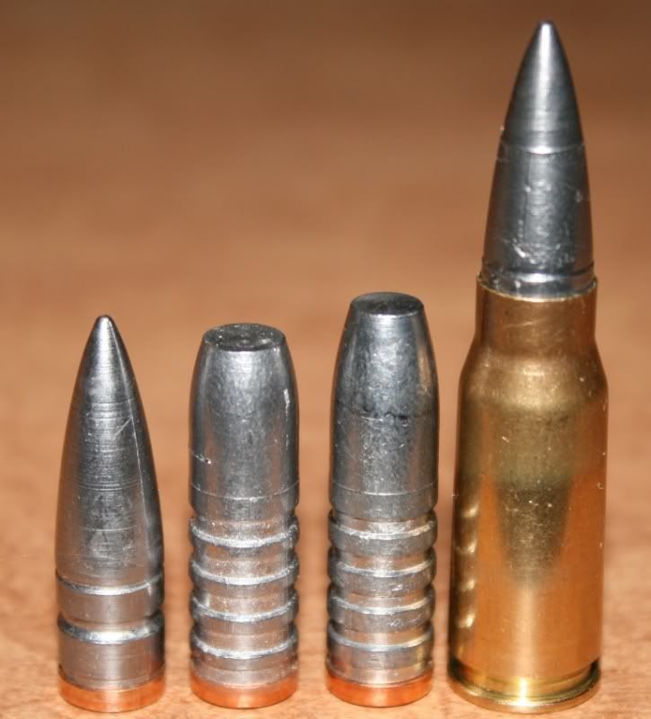

We quite like the idea of a pawdy* carbine in 7.62x39, maybe even wildcatted to shoot something big an dheavy. We're a fan of thumpitty rounds, especially subsonic - like the Russian 7.62 x 39 necked out to fire a 9mm round for subsonic applications. What might be possible, oomans ?
The diagram below suggests to our tiny mind that it might be possible to seat a nice big 198 gn Spitzer bullet (maybe a cast boolit !) from a 7.92 Mauser in the case if the bullet were seated deeply.
and we've just found these, based on a 7.92x33 Kurz case, to keep Dromia happy
* handy, in bald monkey terminology

Re: 7.62x39 improved
It would be interesting to make a 7,62x33 as opposed to the 7,62 Kurz and maybe even blow the shoulders out a tad. I would say shoot it in a Mosin Nagant type action with a modified bolt face, I did the drawings for such a thing a while ago and on paper it is quite possible however it involves some work on the extractor system.
So the wheel goes round - my 7x33 is a 70 year old concept!ovenpaa wrote:It would be interesting to make a 7,62x33 as opposed to the 7,62 Kurz and maybe even blow the shoulders out a tad. I would say shoot it in a Mosin Nagant type action with a modified bolt face, I did the drawings for such a thing a while ago and on paper it is quite possible however it involves some work on the extractor system.
The only drawback (if it could be so considered!) is the twist rate that suits lighter (less than 90gr) boolits.
Not a problem in my eyes as it will see off vermin and small deer.
It also suits light cast boolit loads to shoot at 25yds
