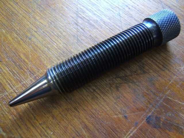

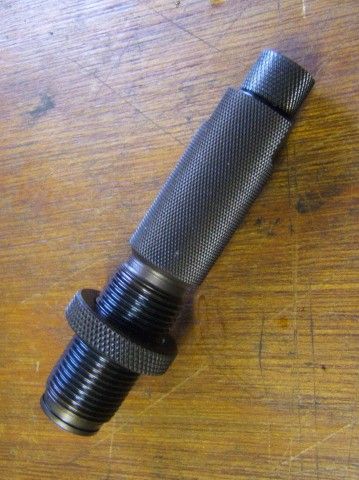

A universal (0.125 - 0.410 ø) Neck flaring tool;
The Plug;

Was only in the 'not buying' category, recycling some gear and making it for the hell of it plus being a tight git helps!

Did look at some calibre specific à la Lyman 'M' dies.
I ultimately went for the 'shallow' taper plug as it was a little less aggressive on the case mouth.
The plug barely 'kisses' the case mouth - just enough that a bullet will sit without tipping.

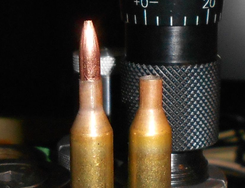

Here is a photo that I have just taken, I was trying to show the flare but it is so slight that it is barely perceptible.
Both cases are flared. You can truly feel the flare when you bung a bullet on the case mouth!
