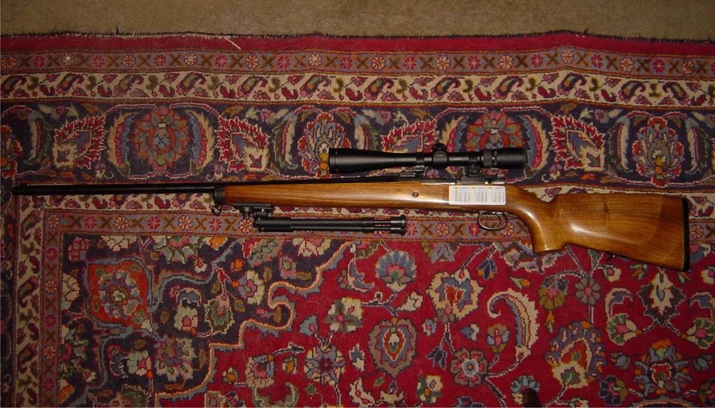

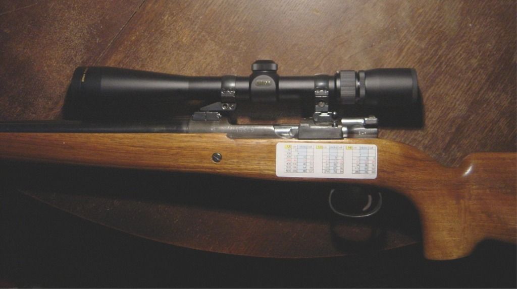

not being a TR-purist any longer - due to old age , I have committed the very same sin and stuck a scope and legs on my CG63 in 6.5x55
That way I can at least still hit the center of the target which produces good feelings clapclap
here a few (not very good) pics of the tool
the scope is a Nikon 4-12x40 with BDC which is brilliant!
The mounts are german EAW Apel swing off mounts, which are excellent! You can take off the scope, replace it and you are exactly where you were before!
Best regards from Kent
Gunter
Gunter
