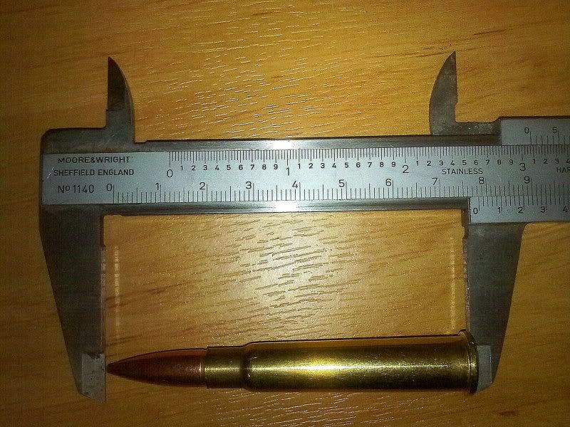

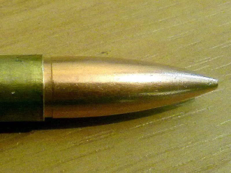

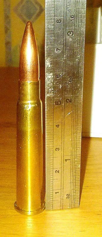

Right,a few details.The rifle is an Enfield No4 Mk1 Longbranch 1950 if that makes any difference.Bullet weight is 174grns,powder Alliant Reloader 10,Privi cases neck sized with Winchester primers.Normally shoot it at 100-300mtrs,but occasionally at 600.Im not trying to set the world alight with accuracy or to break records-to me its just a hobby that i enjoy doing.If the OAL is not acceptable i'll simply seat it further in.
Figured a few photos of a random round i made might give you an insight.
Measured with my vernier.
This is how much much i allowed the bullet to sit out.
Measured with a steel rule.

The OAL looks fine, it doesn't really matter so long as it fits the mag, provided you want to use the mag.
My point is that you will get bigger improvements working with your powder charge weight and burning rate rather than faffing around with OAL especially as you haven't taken a chamber cast yet.
