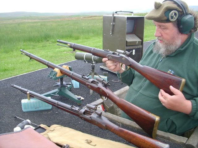

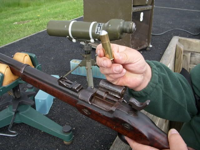

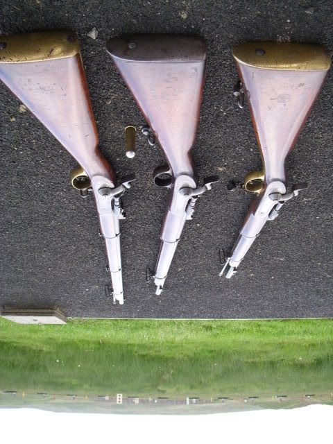

Some of Droomies Snider's :flag13:
Re: Snider
#45 Post by ovenpaa »
What is the middle one in the bottom picture other than a three band?
Posts: 20224
Re: Snider
#46 Post by dromia »
MK1*
Re: Snider
#47 Post by ovenpaa »
That is Mark one star? Can you tell us a bit more about it please?
Posts: 20224
Re: Snider
#48 Post by dromia »
The MK I* improvement of converted Enfield rifles was effected not long after the introduction of the MK I conversion to accommodate the introduction of the MK II ball cartridge. The only difference being that the rear of the barrel was countersunk to take the square rim of the MK II cartridge rather than a rounded recess for the MK I ball that the MK I rifle conversion was made for. There were accidents with the MK I ball so MK II ball was developed to try and improve the cartridges functioning.
