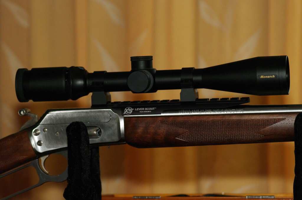

Alpha1 wrote:I have a genuine excuse for fitting optics to my rifles two and a half hours of eye surgery that left me with not to good vision. But even with my duff eyes and my home loads I could put them all in the black at 25mtrs with my trapper.
Optics on a under lever I feel ill. :roll: :roll: :roll:
As already reported on here, I have eye trouble too...don't worry about it...I can't do iron sights at 50+Metres. And I 'm not consigning myself to shoot 25 metres at paper. I'm going to get some fun out of my Marlin.
Wonder how it will print at 100?
And my Nikon is as good looking as any scope. 8-) :D

Are the Marlins all ready drilled and tapped for mounts I have never noticed or do you have to have the reciever modded. I have fitted a williams aperture sight to my trapper it adjusts for windage and elevation. Never thought of taking it out any further than 25mtrs may be I should give it a try. I usually shoot it with 38 special loads suppose I could beef it up to 357 and have a play. :P

No drilling required...I've fitted an XS Lever Scout...£50 from MidwayUK, probably less if your dealer stocks one.
I've taken my Tang sight off...it can all go back to original within 15 mins inc a coffee and a natter with your mates.
I have a Williams also...no better than the Tang sight...bit more sight radius with the tang sight.
Harris bypod doesn't fit...use sandbags.

NB To avoid tears, use rings high enough for trigger spur to clear.
