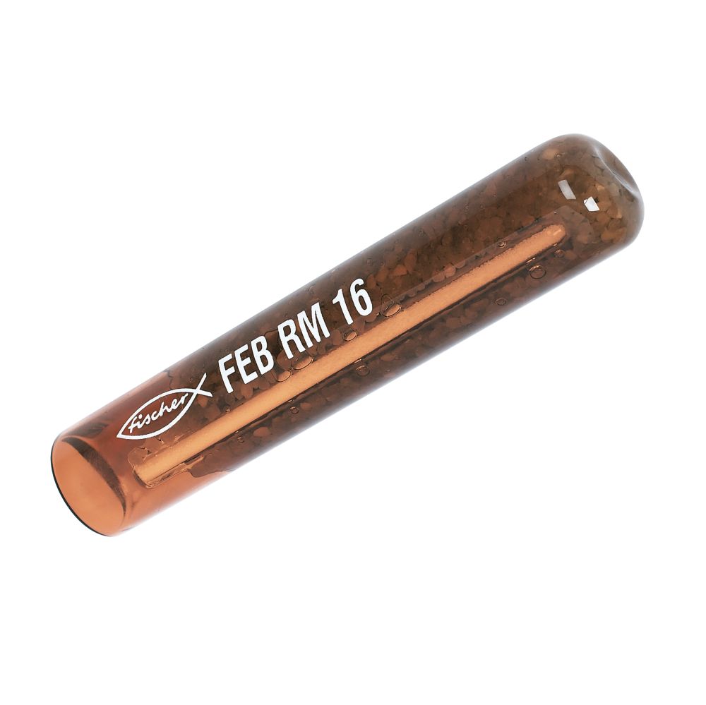

My FEO suggested threaded rod, fixed into the wall with an epoxy
I have also used a special pack for the self same purpose - slightly smaller than a length of threaded rod - but quite successful so far!!
Used in conjunction with:
The technical bumf -
http://www.fischer.co.uk/PortalData/18/ ... ngs/17.pdf

I can vouch for the chemical fixings, just remember to fully tighten the fixings the following day.

One of the various chem fixings is your bset bet. 2 types I have used on industrial windows into soft block are
A glass vile with a 2 part resin that mixes as you break the vile, then spinn the stud/rod to mix. this would be awakward through the pboard cavity to the blocks.
The second type is a 2 part resin in a mastic type tube with a nozzel that mixes it as you sqyeeze it out. This would be easier to do as the nozzel should be longer than the cavity.
