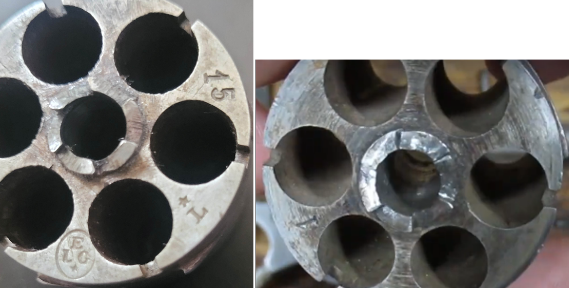

Thank you for the suggestion Dave, no it doesn't, however with help of Google Images I think I have found the problem
In the photo, the cylinder on the left is mine, the one on the right clearly shows sharper features for indexing

Thank you 1066 for taking the time to send the diagram, I think you are absolutely correct

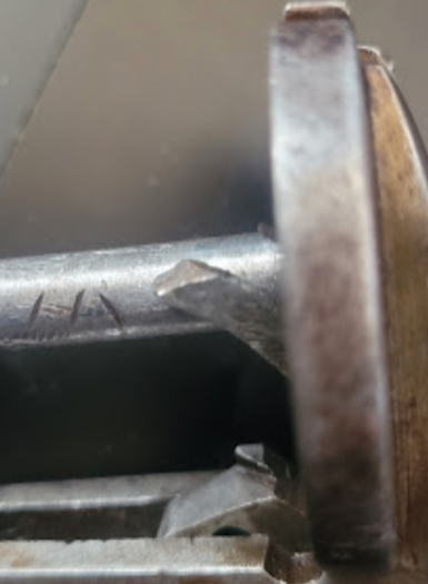

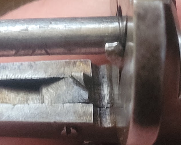

Re: Belgium Pinfire Revolver
Can you post an image of the trigger/slot so we can see? These were hand made/finished and I suspect not particularly expensive so what you describe may well be the case. If so, it may be that judicious use of force to extract it would be the way...... where are you based? I'd be happy to help if nearby.
