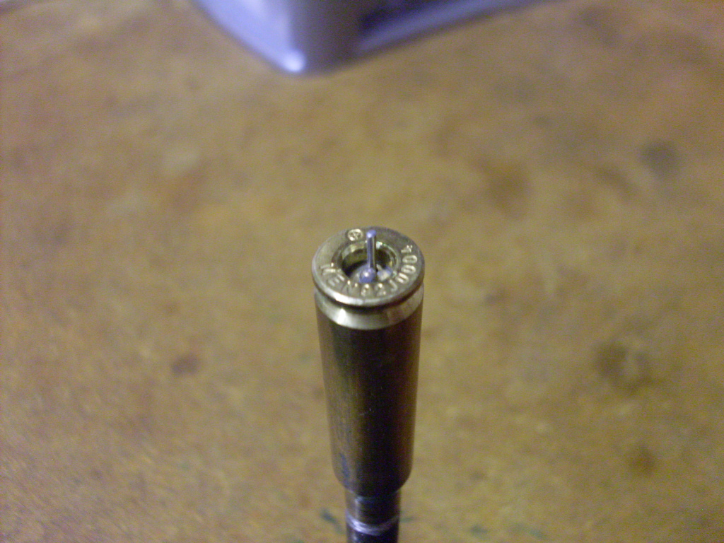

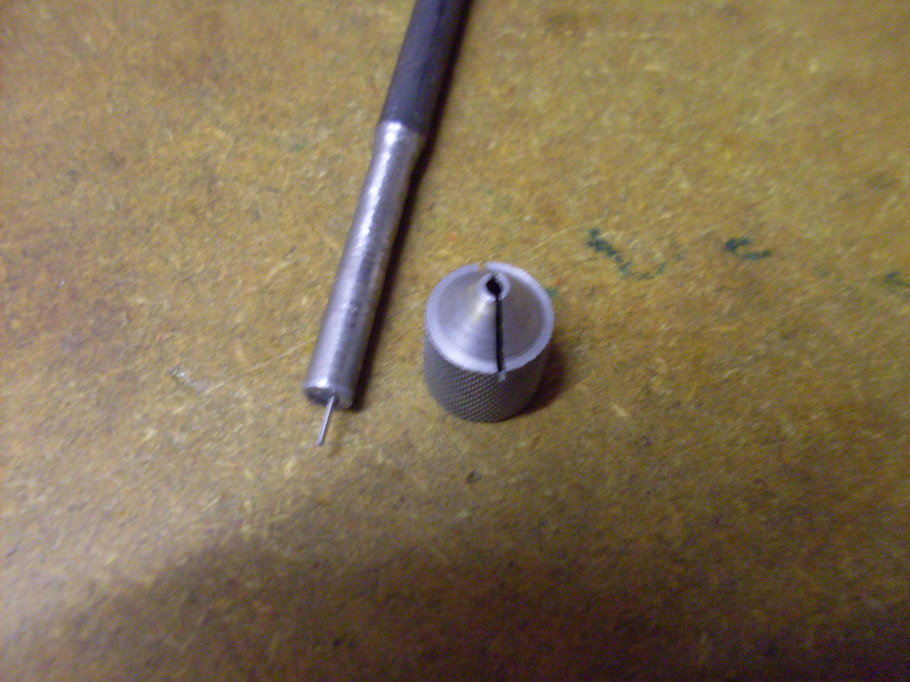

My method of de-priming and removing the primer crimp from Berdan cases using a Lee chamfer tool and pin.

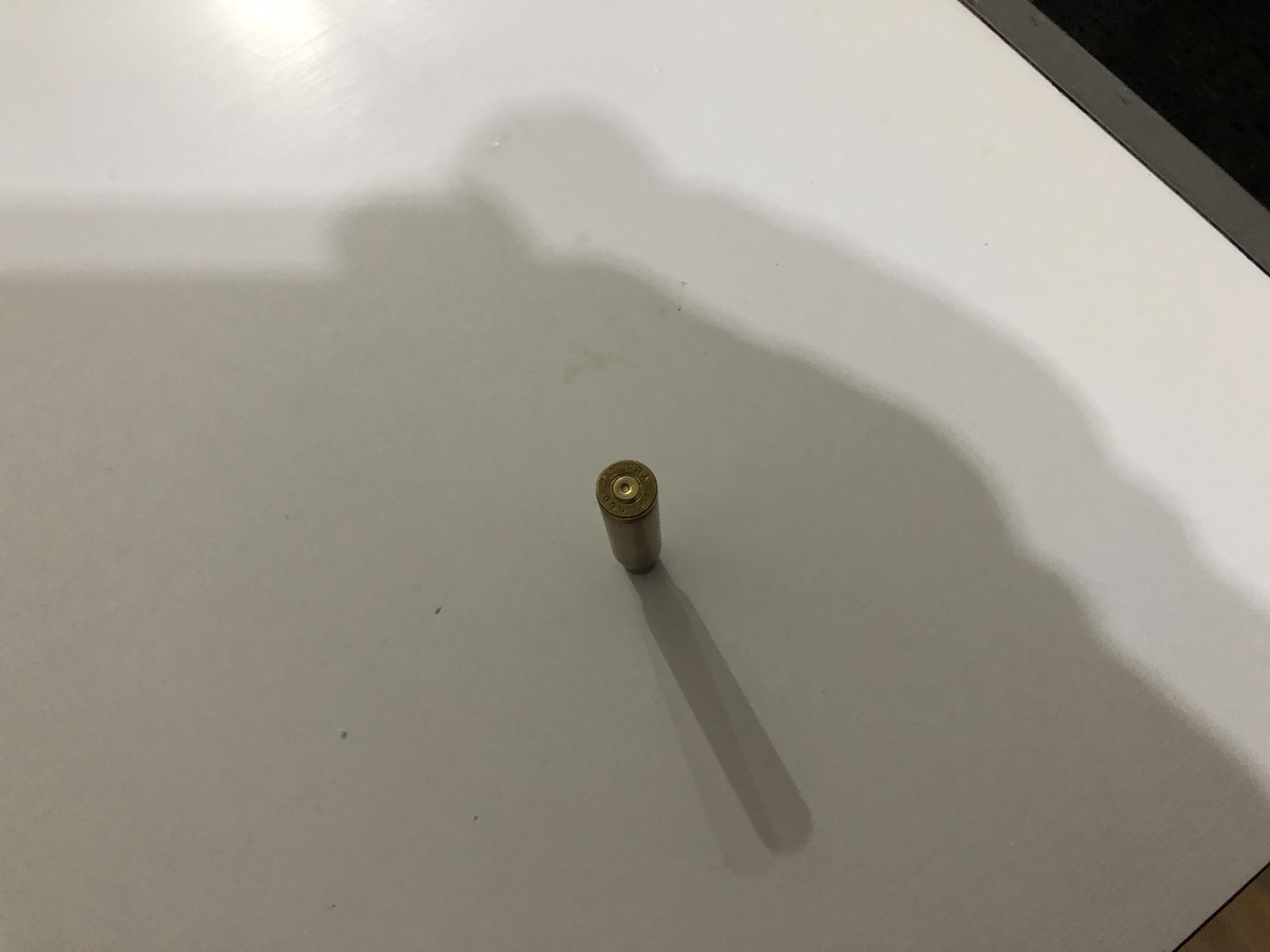

Looks like it was sh1te on the firing pin after all, this is one of 5 cases that I just set the primer off to annoy the wife and gee up the lab!
One thing it's worth pointing out is that the primers actually moved back to just proud of the case head by a midges dick, but they all went bang.
Posts: 20242
Re: Just a word of caution regarding nato 7.62 brass.
#15 Post by dromia »
Primer movement is common in low or no (as in this case) pressure firings.
