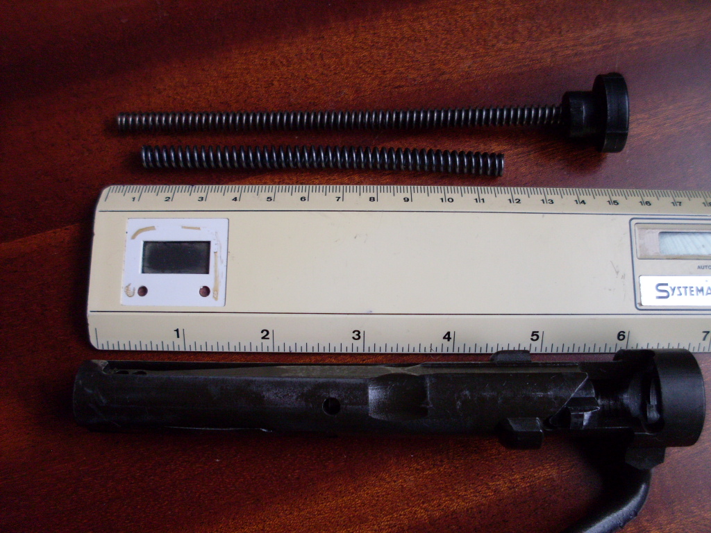

The MAS 36 is a very underrated well designed rifle and compare well with other military rifles of the era but being French, they are a bit quirky!
The following link poached from another shooting forum will answer many questions you may have.

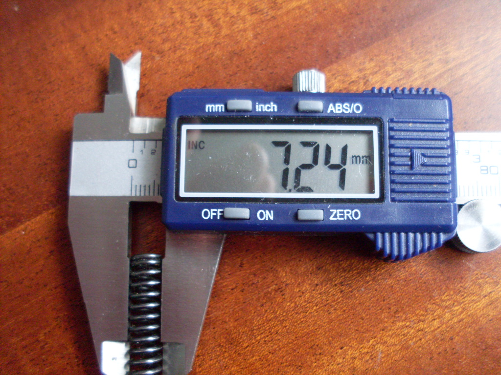

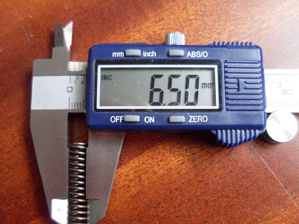

You may well find that the trigger pull is on the heavy side and an easy fix is to replace the firing pin spring, a cut down M1 carbine spring is ideal if you can find one.
My MAS 36 was an un-issued arsenal refurb and it came with an 8 1/2lb trigger pull which was reduced to a comfortable 4lbs with the replacement spring.
The shorter, heavier spring in the photo is the original.
I would advise you to read the link as it may save you some grief in the long run.

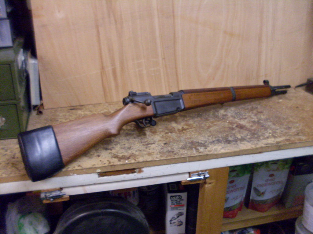

Thanks for the info, i will try and source a spring from the states, i also understand the butts might be on the short side so was going to buy a rubber butt extension pad as well.
The one i have bought is also an arsenal rebuild rifle in excellent condition and it being a bit odd doesn't bother me at all, i just fancied something different.

- Posts: 756
Re: French MAS 36
Some where here or elsewhere, some shooter said you could clean up the trigger pull of the MAS 36 by replacing it with a US GI carbine recoil spring cut to the same lenght as the orignial MAS spring. Well, I had a few spare GI springs so I cut one and replaced it. Sure enough, the trigger pull must be 5 pounds now and nice instead of 40 pounds and distracting.
The above comment was poached from a US forum, but explains which spring to go for.
If I remember correctly, the M1 spring is about 10" long and needs to be cut down. I would advise that you cut the M1 spring about 2" longer than original MAS spring then reduce a coil at a time until you get the trigger pull you are looking for.
Don't overdo it, otherwise you will end up with light strikes.
ukrifleman
ukrifleman

ok so jts the recoil spring i need, seen them and there cheap enough to buy a couple to play with, i wasn't too sure if it was the firing pin spring but there just as cheap to buy.

- Posts: 94
Re: French MAS 36
Had it out again today to check the points you mentioned, the sight leaf is marked with an N and all the woodwork is solid and shows no sign of movement so again all seems good.
ive come across those security screws before and its an easy job to make up a screwdriver bit to fit (i am a retired machinist so making one on a milling machine is not going to be over taxing).
One question is when i eventually get to the range with it and find the sights are off, how easy to get your hands on the offset sights, i assume from France!!
Ian
