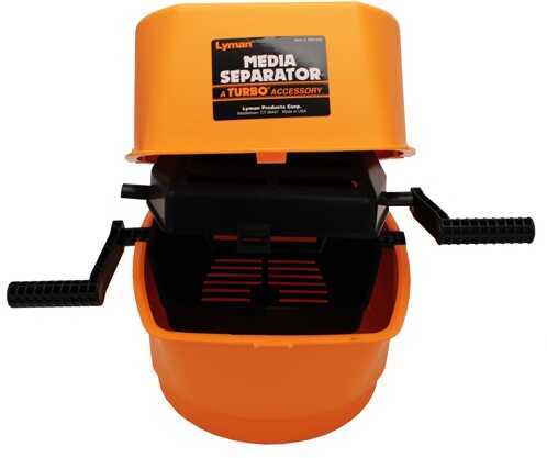

Rotary media separator, fill the base to about 2" off the top edge, enough water so it covers about 1 - 2" of the rotating basket when it's immersed.
Tumble slowly for about 2-5mins in each direction :)
One of these nice deep ones works very well,
And of course, ALWAYS check your primer pockets for pins before priming, they can get stuck in pairs in the flash hole or across the primer pocket with the odd short pin.
