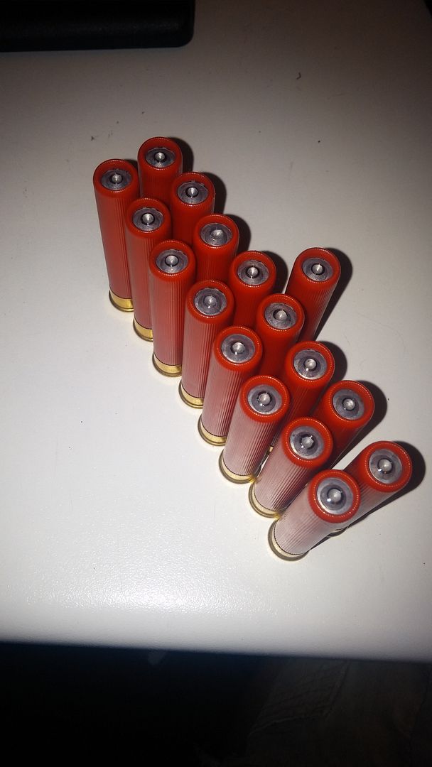

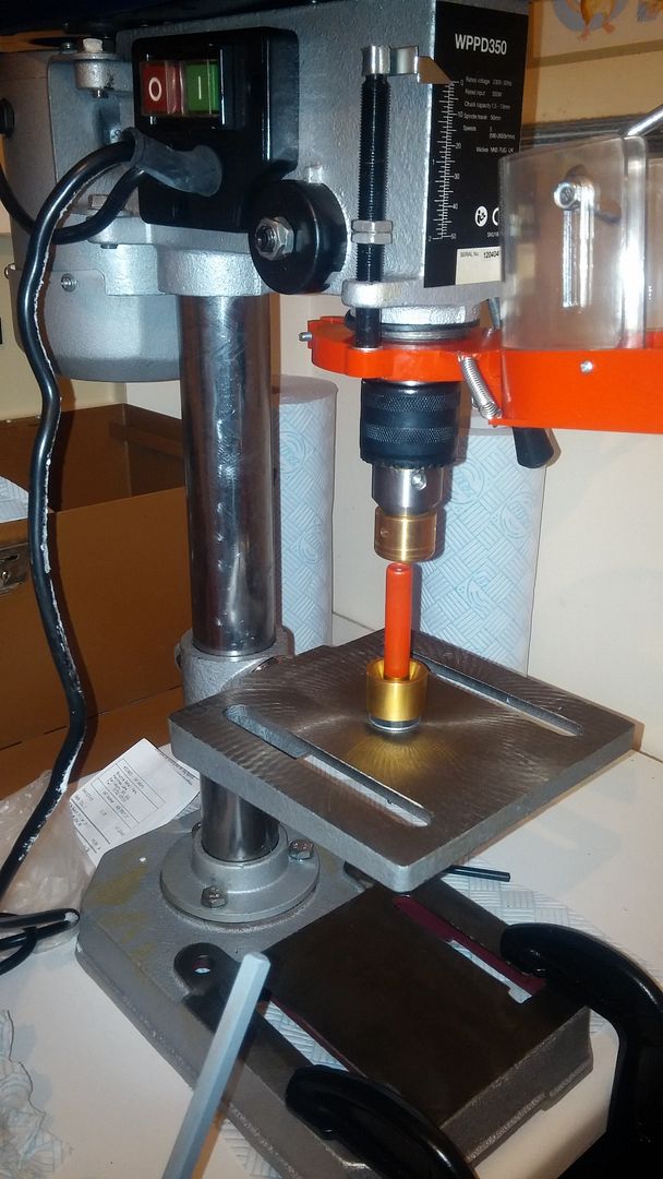

Finally got round to loading some slugs on my drill press.
Shot nicely, 18gr of 'Lil Gun, over powder card, plastic wad and slugs from Siarm in 2½" hulls.
25 yards off hand open sights.
