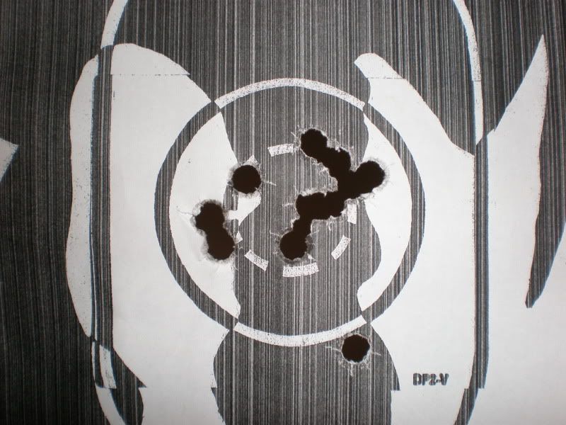

Tried a 10 shot group at 25m tonight, sitting with the front end rested on a bag...
I was pretty happy with that, but if I could hold it steadier I'm sure it'd be much tighter...
