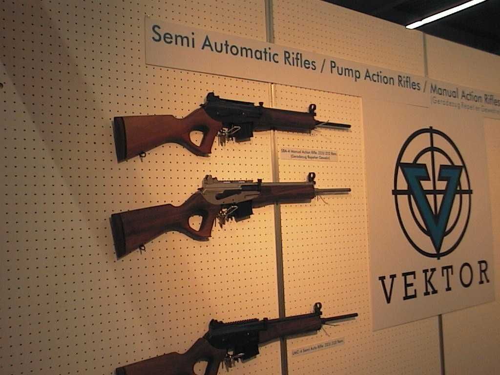

Would the Vektor H5 be section 5 in the UK, being a pump (even though the mechanism I'd really just a straight pull)

Pump Action C/F rifles would be S5 AFAIK.

Demonic69 wrote:Would the Vektor H5 be section 5 in the UK, being a pump (even though the mechanism I'd really just a straight pull)
It would seem the Vektor was available in straight pull
Looks like an Ak action with hideous wood added.
