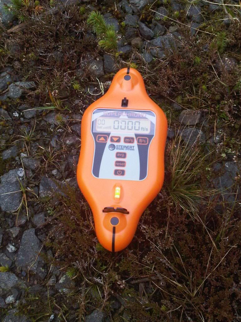

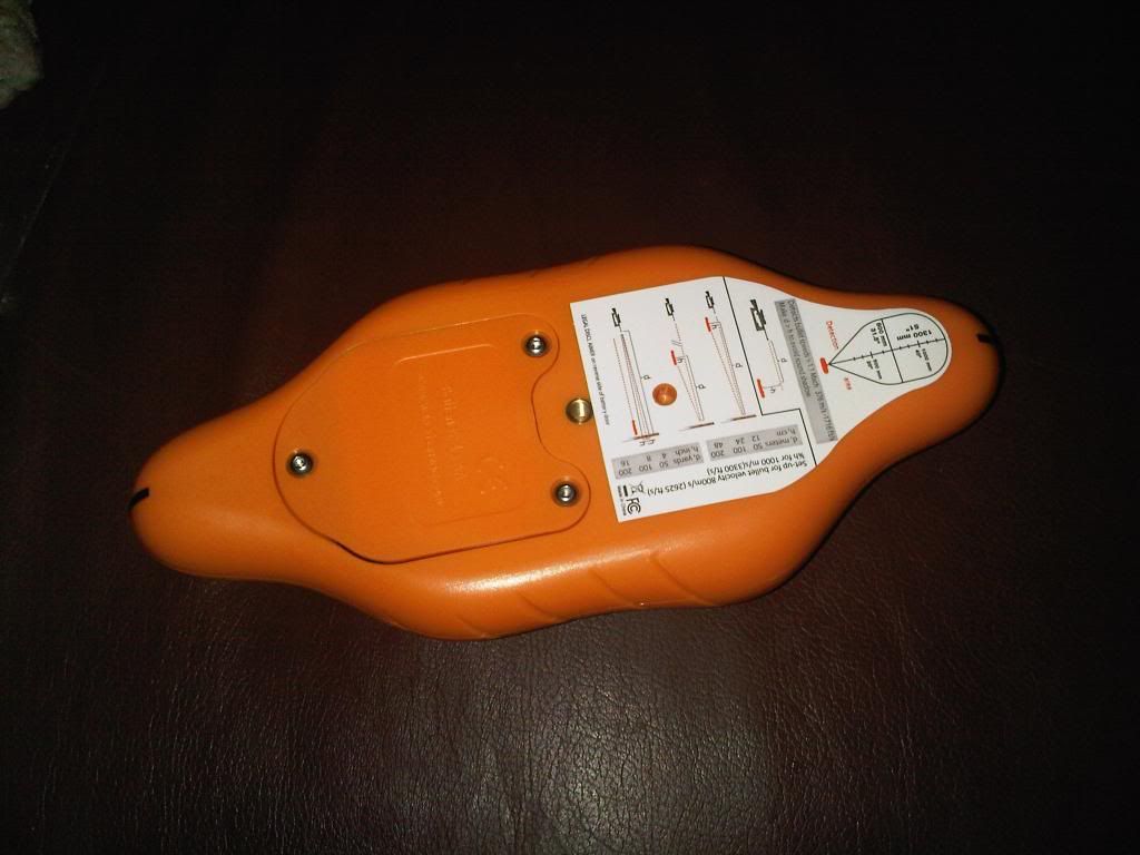

Setup
The unit is supplied with an allen key (metric size) which is used to remove the battery pack lid and install 4 x AA batteries (not included). There’s also a threaded hole on the underside with which to fit a photographic tripod. There’s also a sticker repeating the siting instructions for those who couldn’t be bothered reading the original instructions or have forgotten.

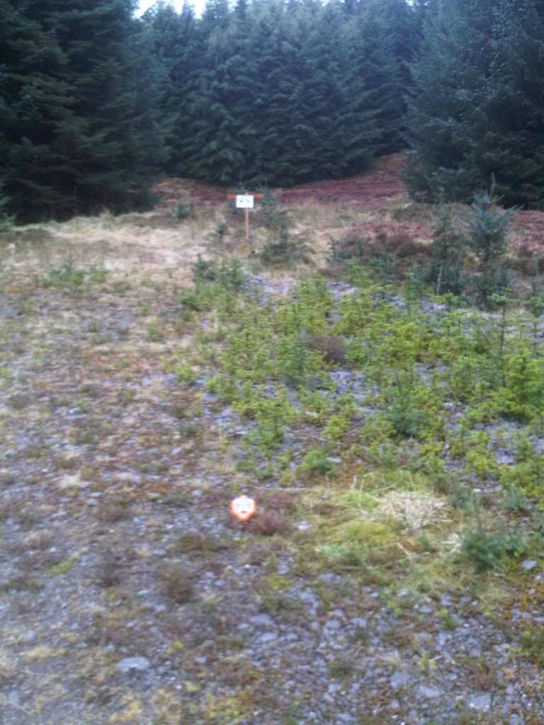

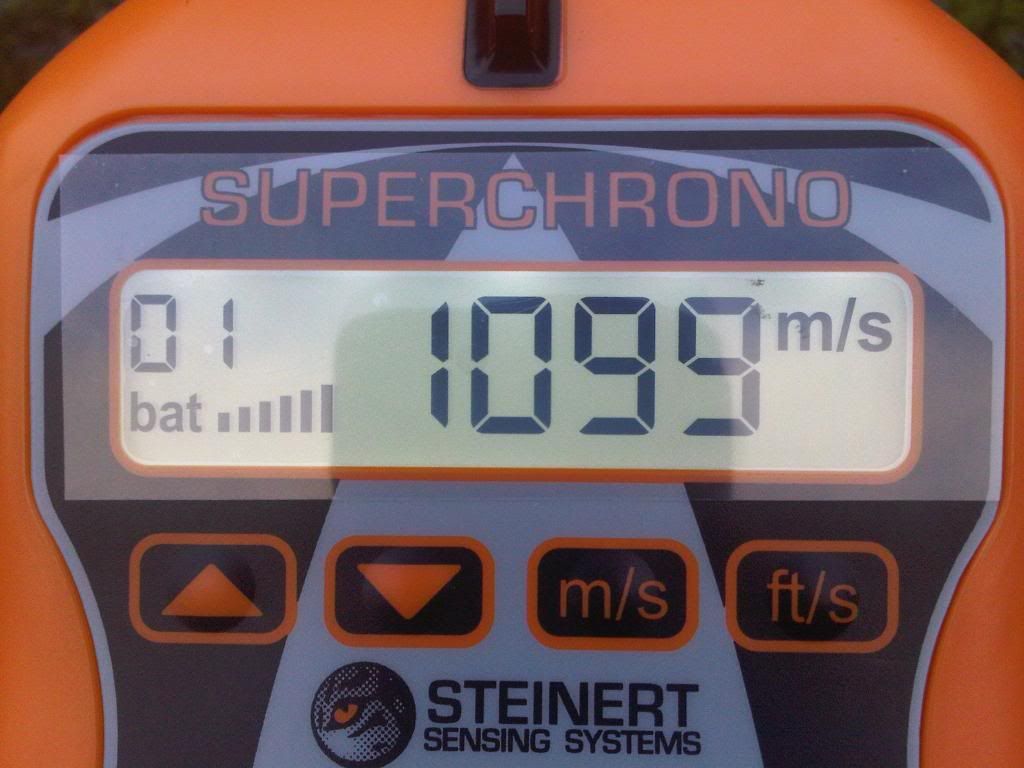

I set the chrono approximately 40yds from the target and then withdrew a further 150yds approx. The handheld laser read 192yds in total. The chrono has a pair of sights similar to those found on a lever action rifle, mounted at the front and back. Provided you sight along these sights and position the unit in line with the bullets path, it will record the velocity of the bullet as it travels over it. The only other consideration is ensuring that it is level. This is helped with the addition of a small spirit level positioned on the top face.

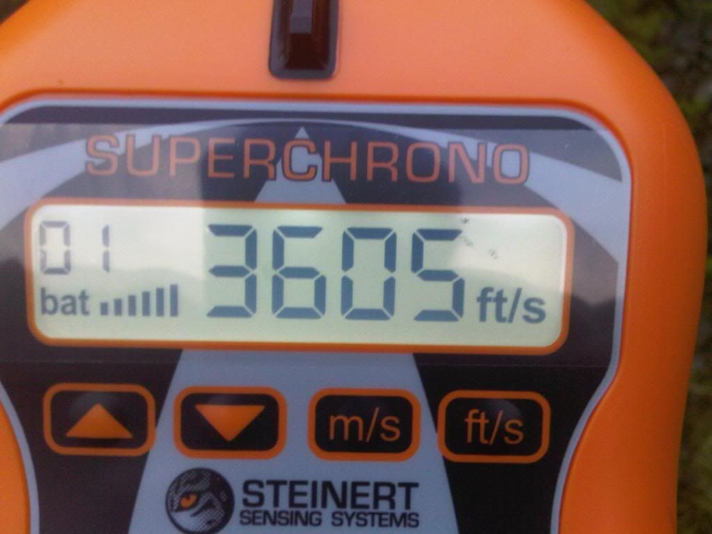

The chrono will read the velocities in either feet per second (ft/s) or meters per second (m/s). You can switch between both without fear of losing your readings at any time and an average will be calculated upon pressing the average button. Just remember to clear old readings by pressing the reset button. I didn’t and got thoroughly confused.
At the end of the day my friends and I had successfully recorded velocities using calibres including .243, .223, .308, 22-250 and 25-06. The only failures occurred when we deliberately acted like numpties and attempted to confuse the unit.

Setup

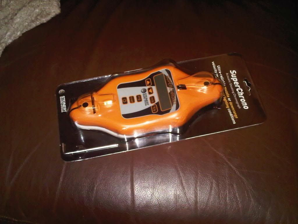

Pictures are just fine...
A customer of ours commented that the packaging looks like a Halford item, ready to hang in their shop :lol: :roll:
