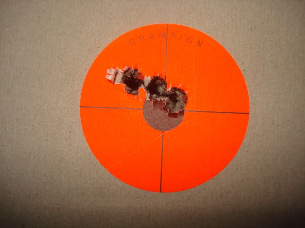

I have an LMT .308, I have tried the following ammo, DAG/MEN, RG L2A2, RG L42, GGG, and Raufoss 7.62mm (L17A1)
The only exctraction issues I have is with the DAG/MEN, though it shoots accurately, it does have the odd, hang up, or tight extraction, all the RG ammo, L2A2 and L42 is effortless (apart from thge pull of a heavy spring smile2)
3 shot group RG L42 100 mtrs

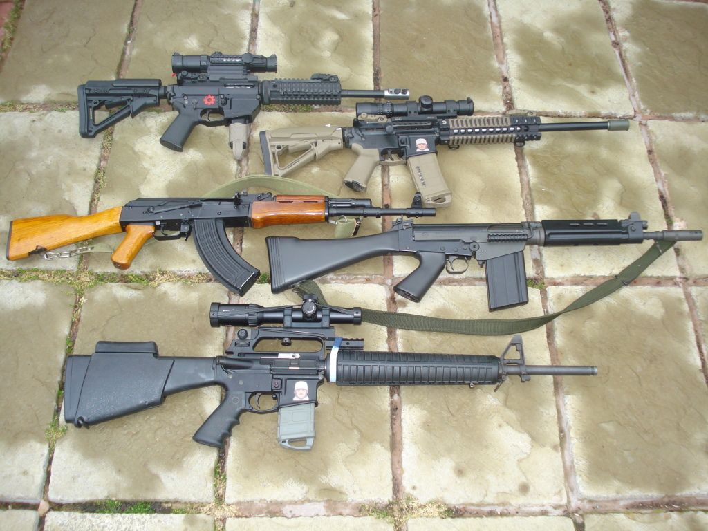

The FAL however, is a different animal, The only ammo it will shoot is PMC (no longer imported into the UK) and GGG. It will not extract any RG ammo, I have tried various L2A2 years of Manf, L42 and tracer with no joy
GGG is effortless, (apart from thge pull of a heavy spring smile2 :lol: ) and on irons, I can hold a 3 to 4 in group at 100, its only a 13 in BBL on the FAL, so it takes a bit of handling, it doesnt come out very often any more, and is retaired as a plinker nowadays. Pic below, you all know what a FAL looks like.
