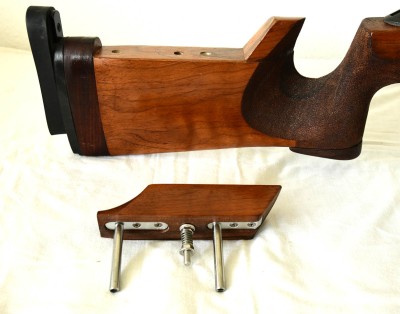

I've been shoe-horning a Tikka M595 223 into a Walther small-bore stock:
The action isn't bedded yet, but it is bolted to two metal pillars, fore and aft. These have been epoxied into the woodwork.

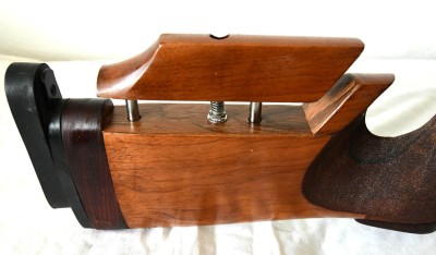

The cheekpiece will need modifying, there's not enough clearance for bolt insertion/removal presently, so unfortunately, it will need a bit of surgery.
Pete
It's still very much a "work in progress" (note the Isopon in the .22 bolt handle slot), but I've got it to the stage where it fits me and it's fireable.Latest project.

Now completed......best group to date 0.33MOA (5 shots at 300yds, 80.5 grain Berger FB's + RS52)
Not bad for an old Tikka M595 (and a Bartlein 8 twist.)
Just pull the comb up and out to install the bolt, instead of removing the retaining screw and having bits of plastic falling everywhere.
The stock is very comfortable to hold, which helps...
Pete
Pete
