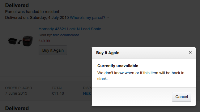

Nick, I have been looking for a good sonic cleaner. Do you have a link to that Hornady one please?
Re: Calipers - Mitutoyo
Unfortunately looks like I bagged the last one they had:Odd Job wrote:Nick, I have been looking for a good sonic cleaner. Do you have a link to that Hornady one please?
But this should take you to it:
http://www.amazon.co.uk/gp/product/B0095I6FC0
